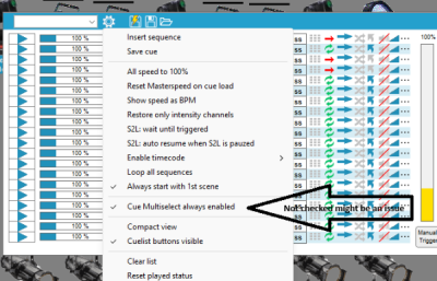

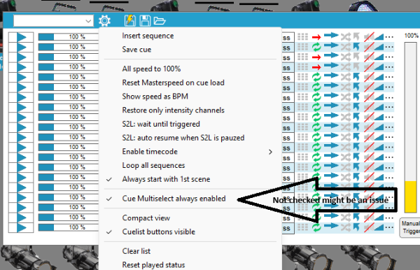

Re: Pan Tilt jumping
This might be an issue
