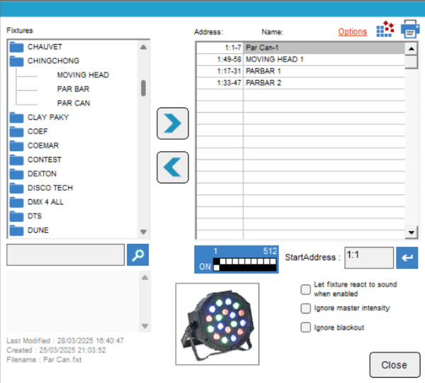

Hi all, first post, bit of a newbie so apologies in advance if this is basics and I've missed something....
I've mastered creating new fixtures, scenes, cues etc etc.... and external control :)
my issue is with the output...
all fixtures are correctly addressed within the 'add fixture' and gapped by 2 or 3 so there's no human fail of overlap.
current setup :
7ch par sat on 1-7,
15ch microbar sat on 11-25,
15ch microbar sat on 33-47,
12ch moving head on 49-60.
Every time Freestyler starts the par will only activate ch 1-4 as can be seen on the output table.

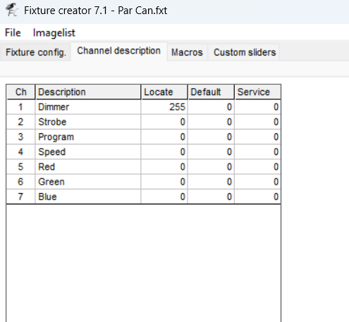

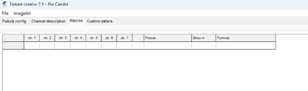

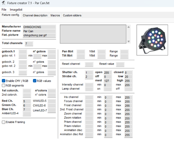

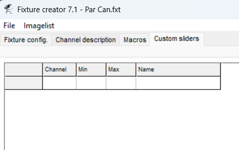

This was from fresh boot up of laptop, checked the fixture settings (ch 3 & 4 are non assigned as not using)

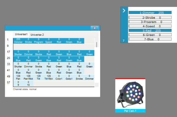

closed this down lighting powered up and then opened Freestyler, selected the par and raised ch 1 & 5 (full brightness & red)
nothing happened, reset ch 5 and raised ch 3 and the par lit up running through a chase, then raised ch 4 and the chase sped up.

now if i go to the setup fixtures, remove it and replace it, it will work... until i restart freestyler

this is the only manual i have found as its a china special and adjusted the dmx channels to suit....
proven firstly on the desk with manual sliders

Second:
In the fixture definition remove the shutter channel and specify the Intensity Channel.
Start Freestyler and do the remove / add (or right click and click on reload fixture).
See if the problem is resolved. (I seriously doubt this is the issue. I tried it both ways and both worked correctly.)

When I restored your backup and started Freestyler I found the Master Intensity was at 0. Once I set it to full the OUTPUT window showed the correct settings.
I still don't understand what is/was happening with your system. Before I found the Master Intensity issue the RGB sliders worked as they should but the dimmer channel (channel 1) remained at 0 - which is why I looked at the Master Intensity.
The Master Intensity window displays when you click the icon found just to the left of GO in the top menu.

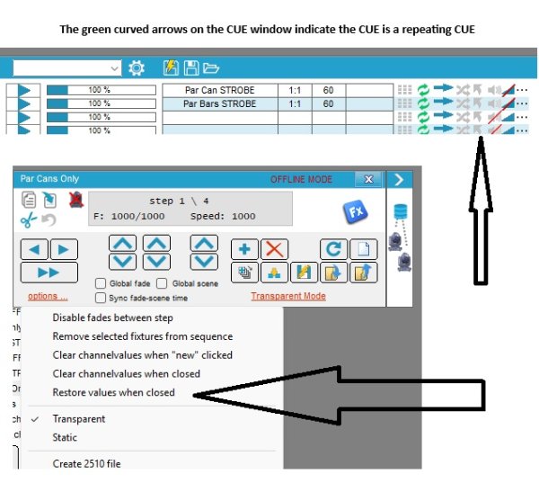

Being new to Freestyler make sure you understand the effects of the CUE repeat setting and the Restore Values setting. Both have caused me grief in the past.
The green curved arrows on the CUE window indicate the CUE is a repeating CUE
The black outlined pointers show location of the Restore Values setting

as there's not an extensive user manual, what exactly do the restore values do? (in english lol)
and is there a user manual other than the online wiki?

I am unaware of any other manual. I believe there are a few YouTube videos.
If Restore Values is active then when a Sequence ends the values of the channels used by the Sequence are restored to the values they had when the Sequence started. I do not loop most of the sequences I create so they often only run for a few seconds. When the Restore Values was added to Freestyler (it is the default) this caused, for me, the intensity to go back to 0 instead of staying at the level selected by the Sequence.
