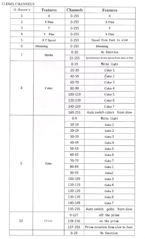

Theres ´s anyone who have the fixture .pff file for those Moving head´s please ?
I´m a beginner and i can make the fixture creator ! :( I can do it ...

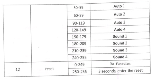

Hello, I bought four UKING ZQ 02061, where can I find or download the fixture profile so I can control them with FREESTYLER DMX.. thank you!! I think the fixture is the same like this one !!

DJCEKO:
Attached is my attempt at a fixture definition for your instrument.
Obviously Aliexpress is not the manufacturer but, lacking the actual name of the manufacturer, that is what I used.
In Freestyler, once you have selected the fixture, Click on Window>>All to open several helpful programming windows.
I could not find the exact fixture so the picture is probably not 100% accurate. If you send me a picture I will update the definition. Also the color wheel and gobo definitions were not given so, in the programming windows, just numbers appear. If you send me the colors and gobos for the various DMX values I will update the fixture definition. Last note, the above documentation listed the gobos 2 times. Normally the second time "shakes" the gobo. I assumed this was true for this instrument and thus the gobo wheel pictures show SHAKE for the second set. If this in not the case I will update the fixture definition.
