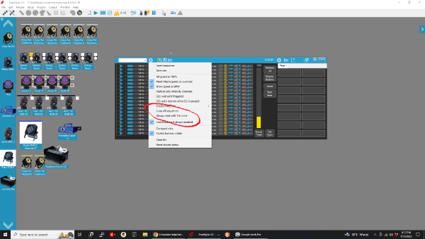

Re: Scheduler help/tutoril request
make sure you don't have "loop all sequences" active and select to "always start with the first sequence"
