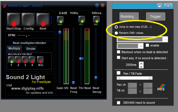

Where can say if the beat is triggered then go to the next step?

Re: Is there a way to say Fixture A take youre colors from Fixture B with SoundToLight
Post by Partyman »
