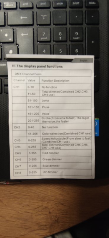

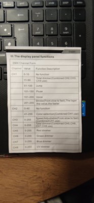

I need help with a fixture for the following LED Mini Cob Par Lights, I've tried using the Fixture Creator but fail.
If someone could help me with this or give me a tip which fixture might be similar... that would be great.
I think it's easy for someone experienced. the lamp has 8 channels attached photos of the manual.
Thanks!!!!!

What version of the Fixture Creator and Freestyler are you using? I am using the latest versions and I do not think that a fixture created with the latest versions (4.1.4 of Freestyler and 7.1.1 of Creator) will work with version 3 and lower of Freestyler.
Channel 1 has a setting labeled "Jump". I do not know what this means. Can you explain?
Channel 1 "Pulse" is probably Strobe.
Channel 2 apparently selects predefined colors. If so, these should be documented also. If the DMX values are known the the Color Wheel function of Freestyler can be used which makes programming a bit easier.
Please tell us the problems you encountered trying to create the fixture. If we can advise you then you will learn more about using the Fixture Creator and will not need to wait until one of us has time to create it for you.

Hi Rod, thanks for your reply and offered help.
I am using Freestyler 4.1.1 and also the latest Fixture Creator,
jump is a color change I assume.

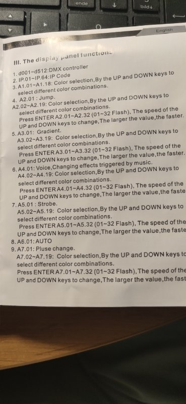

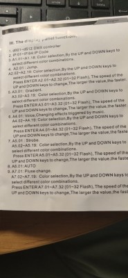

Hello Rod,
I have photographed another page, there you can use the panel to select the various functions. Jump is a hard color change and pulse is probably a smooth color transition
I hope you understand what I mean.
