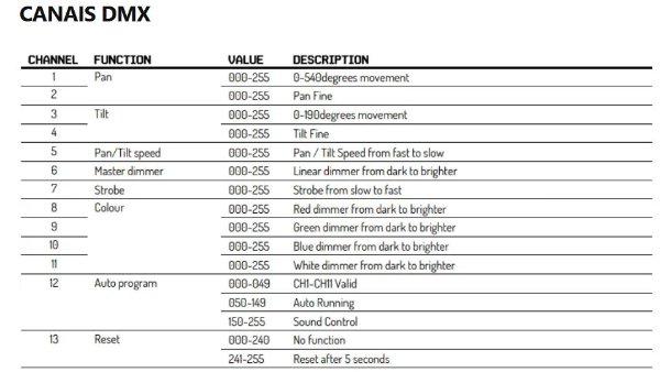

Good morning can you save my work ?
I need fixture for the Panther 85 please
Here are the chanells .
FIXTURE FOR BEAM PANTHER 85 by BEAMZ ! Plase !

Re: FIXTURE FOR BEAM PANTHER 85 by BEAMZ ! Plase !
Can anyone provide me the .pff fixture file please ?
It's not a complicated fixture to create.
Open up the fixture creator, look for the bits that match the label of what I have typed and enter the values in.
Total channels: 5
Intensity channel: 6 (min: 0 - max: 255)
Strobe ch.: 7 (off: 0 - max: 255)
Pan 8bit: 1
16bit: 2
Tilt 8bit: 3
16bit: 4
Click enable CMY / RGB and RGB values
Red Channel: 8
Green Channel: 9
Blue Channel: 10
WW/LED or CW/LED Channel: 11
Download the image attached and put it in the fixtures folder, you can then use that for the fixture image.
The Wiki entry on the fixture creator is at https://www.freestylersupport.com/wiki/fixture_creator
Total channels: 5
Pan 8bit: 1
16bit: 2
Tilt 8bit: 3
16bit: 4
Red Channel: 8
Green Channel: 9
Blue Channel: 10

TOZESURF
- Posts: 35
- Joined: 10 Sep 2014, 19:25
- FreeStyler Version: 3.5.7
Thanks my friend
