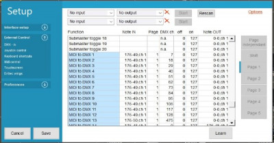

In version 4.1.1. I used direct output from one fader to 12 dmx channels for MIDI control. (see picture)
In version 4.1.2. unfortunately this doesn't work. Fader settings are only sent to the DMX12 channel.
Is this a program bug or a new feature?

colombo already reported, https://www.freestylersupport.com/bugs/view.php?id=1671 :((
I hope it will be fixed, it was a great feature... and link directly dmx channels (I don't know how) It's not the same... If I want with a cue to fade slowly from first head to second to third etc. then I can't...
