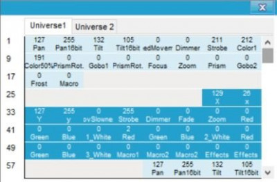

- Some sequences when loaded give strobo to 255 to some, 212 to other fixtures, I can low it to 0/off and save it, it doesn't help. This happens to a sequence with 2 or more scenes, for one scene no problem.

Thanks for answer, all my fixtures have no-strobo when its channel is 0.
Can you please explain me why, when I open a sequence from file, the strobe goes to FAST? Even if I saved the sequenze with OFF strobe before?
Also, why it happens also with "50% colour channel" to 191 value? I saved it with zero.
Thank you
Thank you

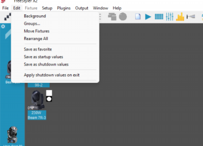

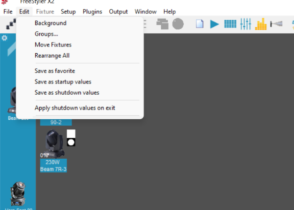

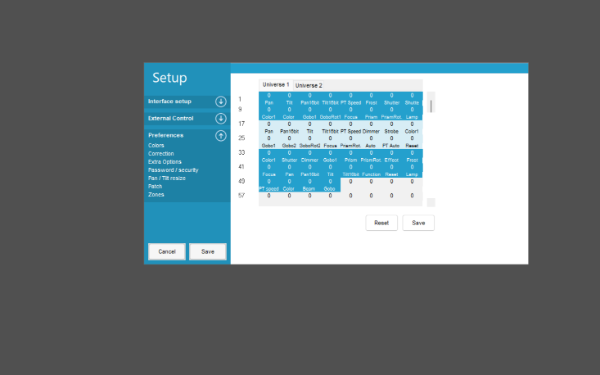

Try resetting your patch and correction settings, and also put all values to 0 and 'save as startup values'
GiovanniG
- Posts: 62
- Joined: 04 Jul 2022, 16:10
Re: Freestyler is really buggy

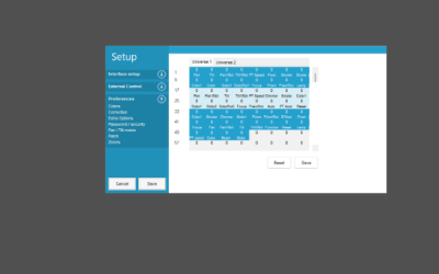

How the patch can be useful for? I have numbers from one (for adress1) to 511 (for address 511m where whe addresses are mapped), I can't put automatically all to 0 as you suggest, do you suggest me to write 500 times 0 manually?
Anyway I set all values of all fixtures to zero (X-Y to middle), and I saved it as startup values as you suggested, I've also saved the scene to a sequence 1/1 called "zero-values". I've closed the program and loaded back, it respected it and all values to zero, then I loaded the "zero-values" sequence and I got this. Inexplicable

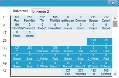

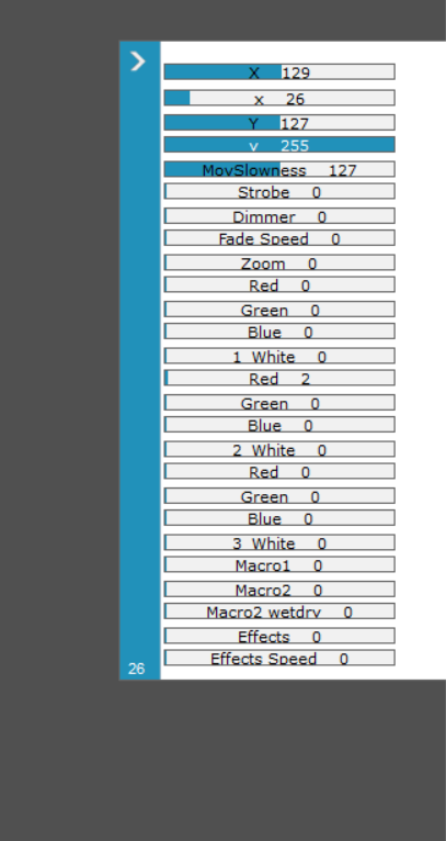

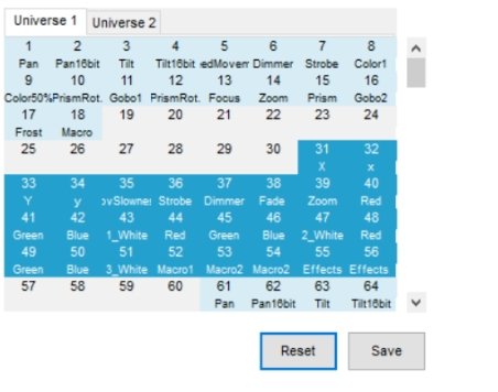

If I reset the vaules I obtain this:
the only way to have them to zero is to change namually, selecting one by one.

Maybe something wrong when compiling the fixture, the editor produces somrthing that Freestyler don't get well.
Which difference there is between pff and fxt? Since the editor can open fxt I was thinking that was the correct format to upload..
Yes I believe there is something wrong with my Freestyler, that's why I'm noticing this bugs.. and that's strange I know.

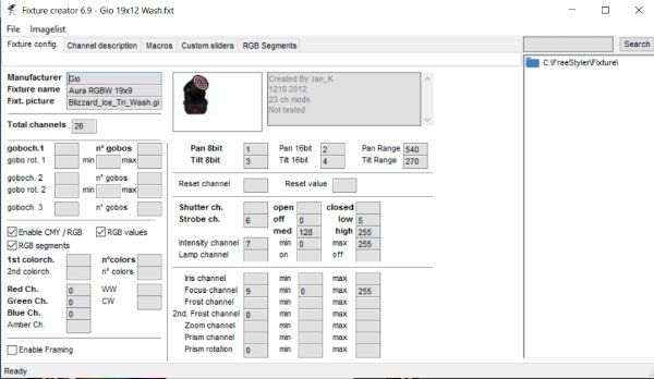

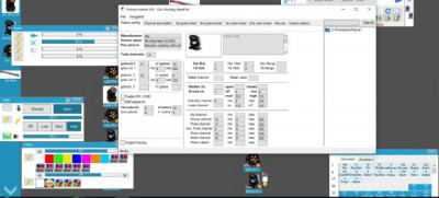

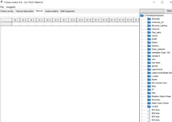

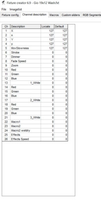

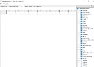

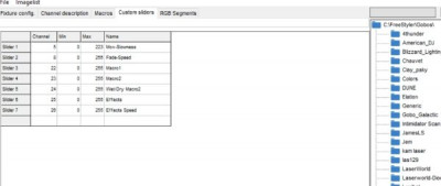

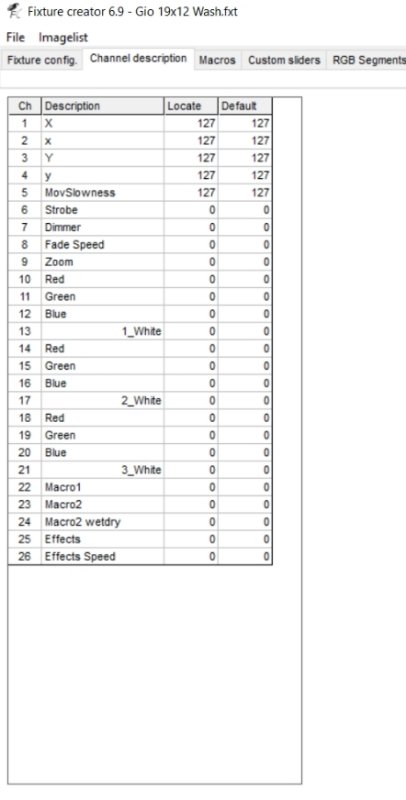

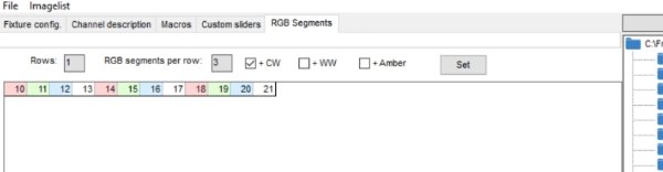

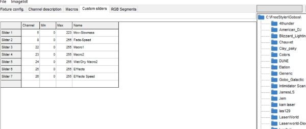

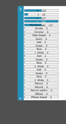

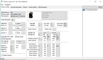

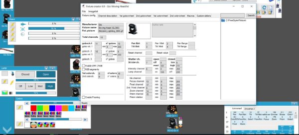

I've clicked on fixture in Freestyler and selected "edit fixture", then the screenshots in the editor:

this is the original file that I uploaded yesterday, before edited with yours.
The problem is affecting all the other fixtures, not only this one. When I loaded the sequence, all of them goes to strobo HIGH. It doesn't matter where the strobo channel is, all fixture has different channel, but all strobo goes to HIGH. I think it's a problem of Freestyler, so I suggest you to open my rar file and test that, if for you is ok then there is an incompatibility with my Win10 64bit
Chinese 19x12W RGBW Aura LED Beam Zoom Moving Head 26ch.pff- (3.39 KiB) Downloaded 155 times
- djSupport
- Posts: 1921
- Joined: 09 Jul 2007, 18:57
There's a back up feature back it up and post the file please

- djSupport
- Posts: 1921
When I load that I see no lights set to strobe, If your setup looks like this and your lights still strobing you have the wrong fixture for the light, try moving all the sliders to zero does it stop strobing? The best thing I can advise you is to uninstall freestyler and re-install 4.1.1 then use the backup file you posted, if your online within twnty minutes of seeing this we can do a remote connection so I can see what your describing because its not easily making sense because non of the lights in your backup are set to strobe
