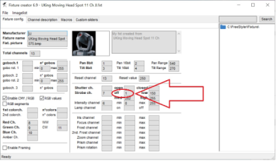

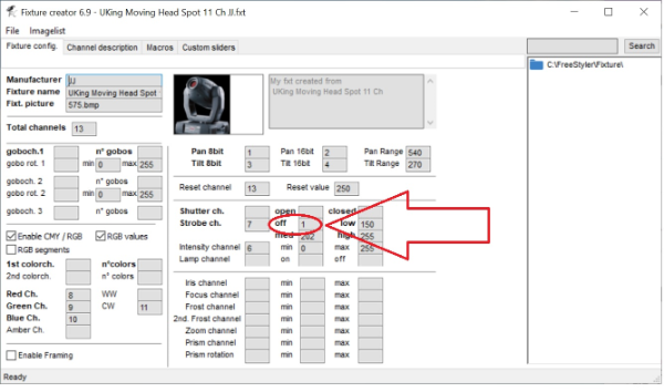

Thank you. I am having to RTFM (Read The Fine Manual). Having the DMX output window helped solve the strobing problem. The way the fixture was set up, FreeStyler could not send a "0". I rebuilt the fixture from scratch. That solved that problem.

I'm an old SYSOP, from CompuServe... very old... But I would just add a single line to the end and say I fixed it, and put up the solution.
Hmm I see that I didn't do the best job, above.
What I did was set the off option to 1 like as follows: -JJ
WOW my attachment sucks...
