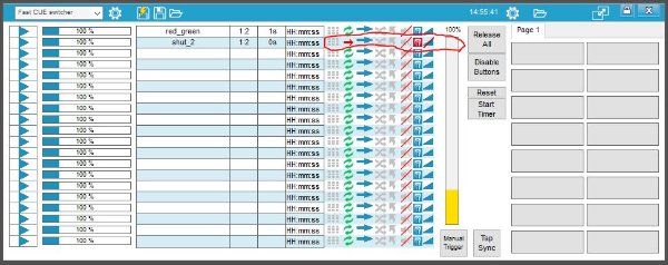

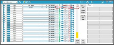

If you alternate these option and save the cue list again the it will remember these settings for you sequence and they will also be used if you use sub masters
