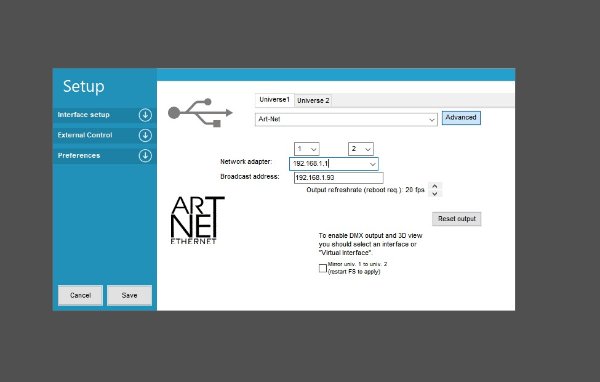

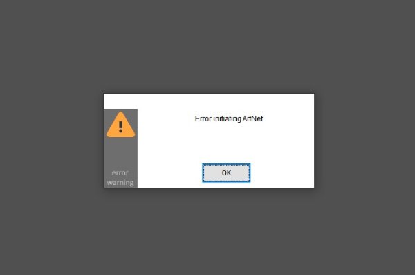

I have a Chauvet DMX-AN2 that I'm trying to get to work with FS. It works over my network with iPad apps (like Vibrio and Photon), but it will not work with Freestyler. No matter what settings input, I get the error message 'Error Initiating Artnet."
I'm using the generic ArtNet setting (but have tried Enttec Ode), with Network Adaptor IP as the ip of my actual router, as well as my computer. And broadcast address as the ip of the Chauvet.
Nothing works. Is this a software thing, or a user error?

Well, I did that. Restarted the computer. Still getting the error. Or just nothing happening at all. When I reopen setup, the Network Adaptor address is always blank, so I have to re-enter the address. That network address is the address of my router. My laptop is .125. Both give me the Error Initiating ArtNet error.

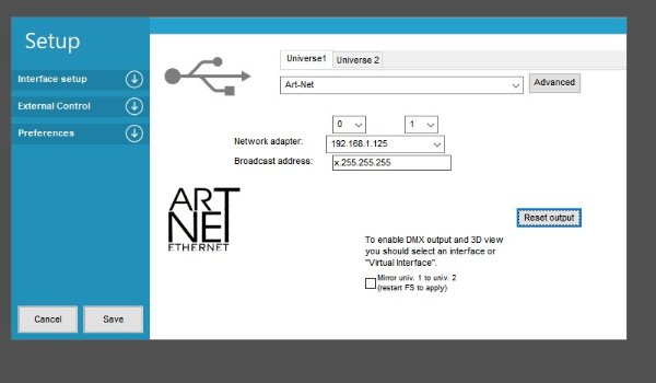

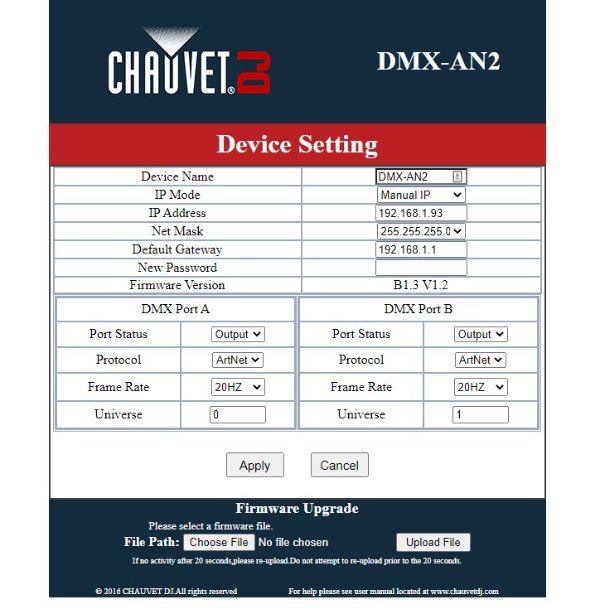

Is your address in the Network Adapter spot the IP for your computer, or for your router? I've attached pics of my Chauvet settings, plus another try mimicking your settings.

In the chauvet image it says to use 192.168.1.93jmo2610 wrote: 16 Mar 2021, 20:53 Is your address in the Network Adapter spot the IP for your computer, or for your router? I've attached pics of my Chauvet settings, plus another try mimicking your settings.
broadcast adress is 255.255.255.255
But i think you can set is in the chauvet settings to DHCP too instead of manual.
