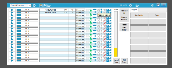

For a small room I am setting up some sequences / cue's to set colours and speed and moves based on music what is playing.
When a party is going on we should be able to push a button like, green room, slow music, house music etc. and depending on that my lights will get their settings.
This all is working fine, but now I made one sequene for hard music that all par's are going on strobo and my laser turns on. This should not run for very long time.
But when I activate this sequence from my cuelist and later activate a normal sequence back the pars keeps strobe and the laser keeps shining. Pars do get the colour from the cue I choose, but strobe is not stopping.
Is there a way to achieve what I want? So I can switch from light show easy while we have a party?
Thanks!
Tim

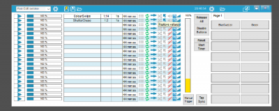

Make sure your other sequences turn off the laser and stop the strobe.
And in your cue player select "restore values" for every cue.
