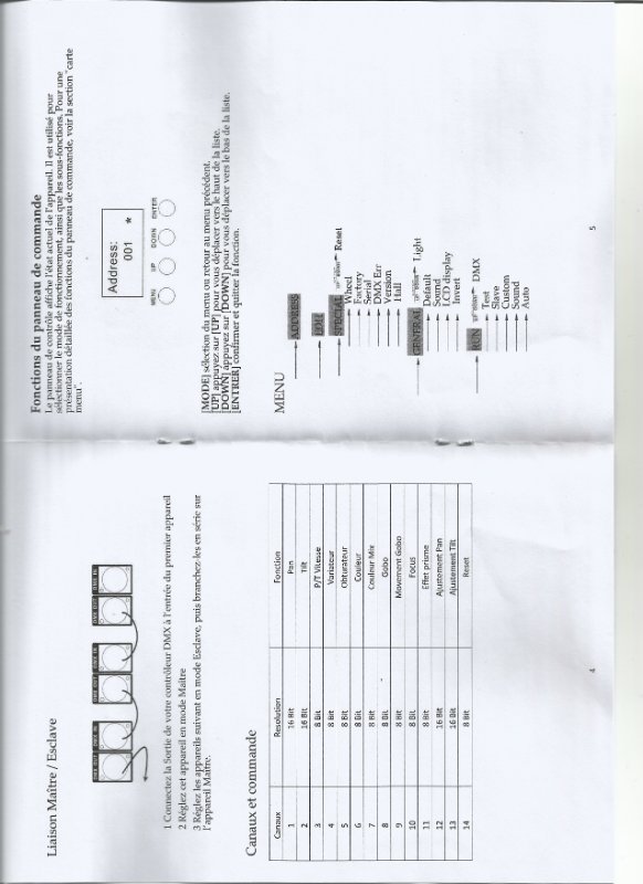

Hello team,
My Second request. Using 2 of these babies and no way to find their files: https://www.youtube.com/watch?v=CCa4fhKNVl0
I have the manual (see main pages form channels attached).
If anyone can help, more than appreciated!
Thanks,
David.

Attached is a fixture file for your instrument. It is a very basic fixture. If you can provide additional information the fixture file can greatly be improved.
To improve the fixture I need DMX the values and the effect upon the physical instrument for the following channels:
5 - shutter
6 - color
7 - color mix
8 - gobo (also images of each gobo would be nice)
9 - gobo movement
10 - focus
11 - prism
The fixture should control your instrument. The information I requested will allow helpful programming windows to be available to you.
Your feedback is very welcome.
Stay safe and well!
