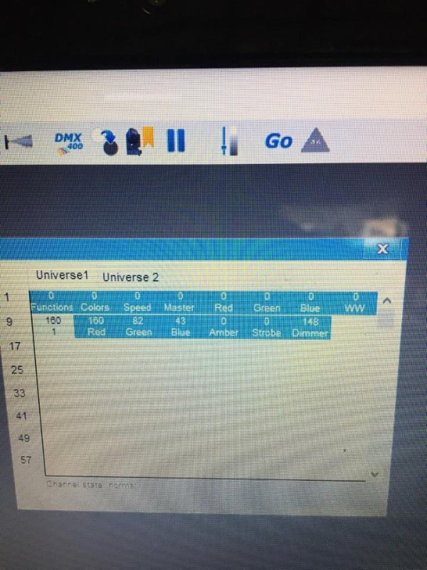

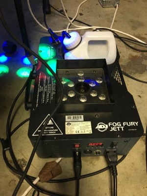

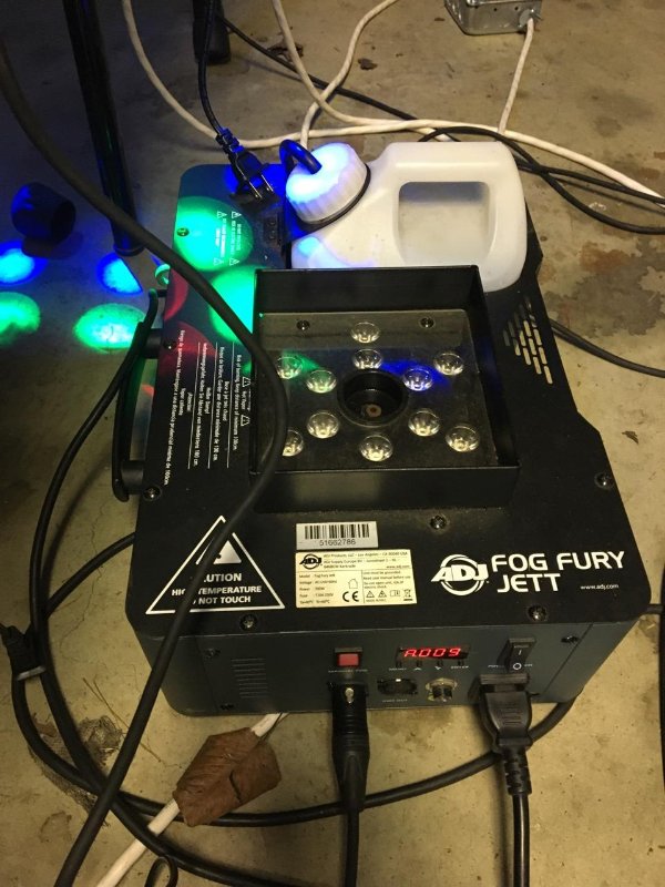

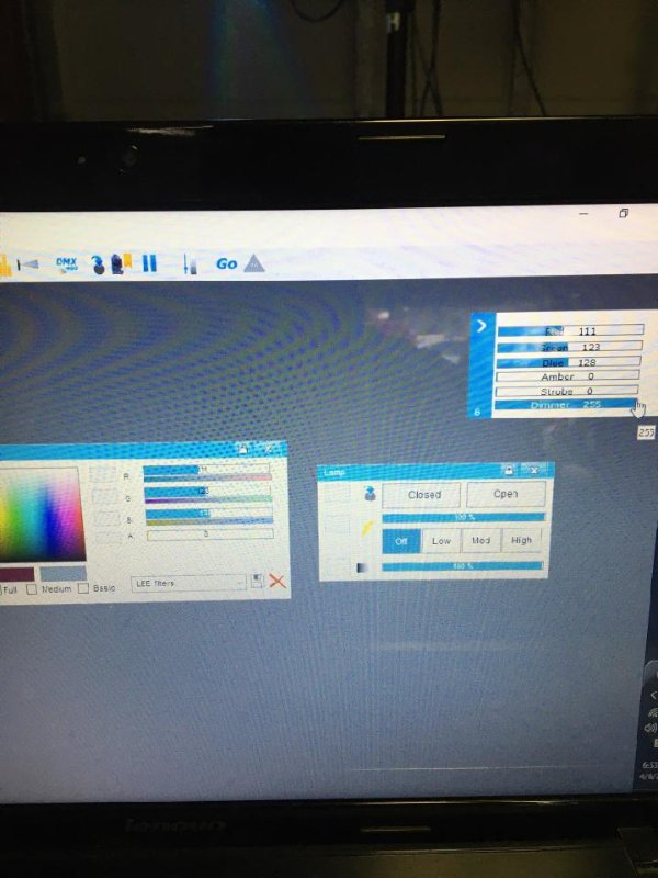

Hi there, i still havent been able to get the fury jet to work properly. Pretty much it just produces fog with random lights for now. In addition, I was able to see the output values sending to each channel. And again if I use the fogger with the address of 116 and light fixture address of 117. Should the actual fixture be on a address of 116 or 117. Dont want to worry you to much about this. For now I will just use it like it is and hopefully I can figure it out. Thanks
- Posts: 905
- Joined: 16 Nov 2016, 14:24
- FreeStyler Version: 4.1.7
Re: Re: Fixture Profile for ADJ
The actual (physical) fixture should have an address of 116.
The Freestyler fogger fixture would have an address of 116
The Freestyler LED fixture would have a starting address of 117.
I'm beginning to wonder if you have a defective fixture. There isn't a DMX value that would cause random lights, at least according to my understanding from the user manual. (You do not have another Freestyler fixture defined with address(es) in the 116 - 121 range, correct?)
In the output window were the values what you expected? If you can take a screen shot or SNIP of the output window when the Fury is fogging and displaying random lights. Upload the screen shot here.
UPDATE: There is a setting that will cause the issue you are having. If you have your physical fixture set to 1 channel mode the physical fixture will react exactly as you describe.

Forgot to mention that i did not have another freestyler fixture defined with those addresses. I might have worded the the part where i stated that when the fog comes on lights produce to. The light values appears to be in full or like with all the lights on.
Djprimetime87
- Posts: 21
- Joined: 21 Mar 2020, 01:01
- FreeStyler Version: 3.4.6
how do i send you a picture in the message
Djprimetime87
- Posts: 21
Never mind, photos have been added
