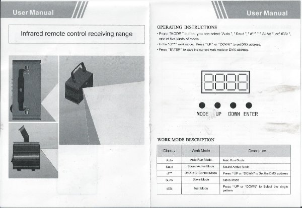

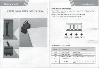

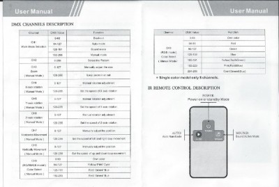

Here You have user manual

Sadly, the pictures are not very clear. There is much information that is not legible. Please see if you can obtain a much clearer picture. Or perhaps type the information.

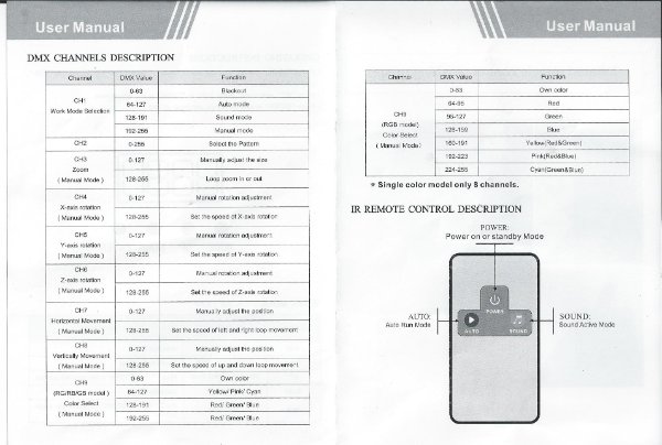

https://ibb.co/b7W05Xq
https://ibb.co/z40ZYQc
that's everything I've got

Thank you for the posts. I can read those. I will try to develop a fixture either this evening or tomorrow.

Attached is my attempt at a fixture for your instrument.
You may access the following helpful programming windows by clicking on Window All
Beam (controls Zoom)
Lamp (controls Channel 1 Black Out or Manual Mode)
Custom Sliders
Macros (controls channel 2, pattern selection)
Note: The documentation did not specify DMX values for channel 2. One of the videos indicated 32 patterns so I made an assumption that channel 2 was divided by 8. I anticipate that some or most of the values are incorrect. A simple edit of the fixture file macros to set the correct DMX value will resolve the problem.
Please test and provide feedback.

Re: your comment, " ... but I have no idea how to create effect like that ..."
Channel 2 controls the laser pattern. I think the effects you see in the videos are a result of the setting of channel 2.
