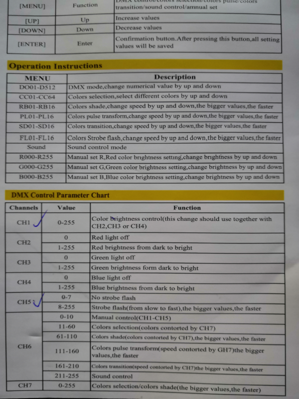

i´m using uDMX and it works great with my TS-2 scanners. But with my new Par Lights from ebay (U King ZQ-B192, looking similar to many other cheap par lights) i have one problem. They change the brightness and the colors, but they won´t glow continous, only flashing for 2-3 seconds.
i´ve found some topics here with similar lights and the same problem. i´ve checked the cable, terminator and adjust the refreshrate but it still won´t work. I´ve also tested some different settings in the fixture.
Maybe there is a hidden setting in the fixture? It seems to me the lights don´t save the signal and flashing because of that...
