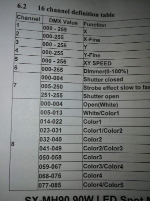

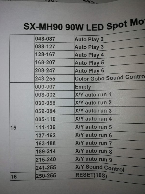

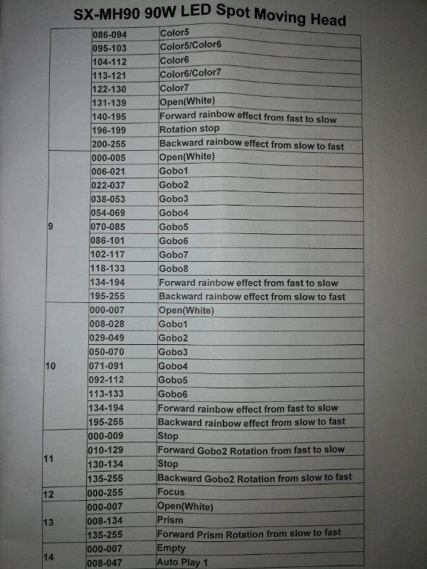

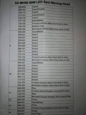

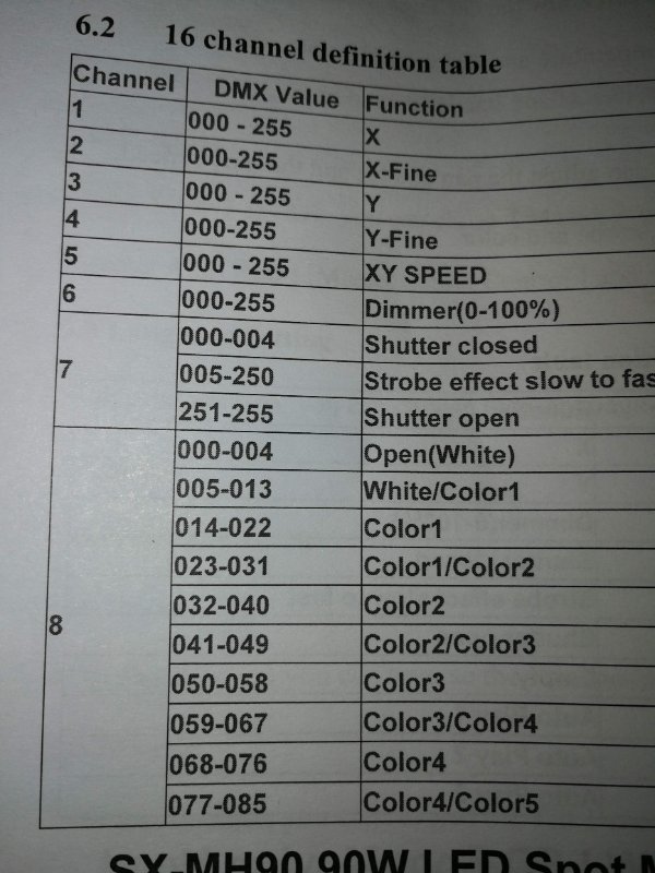

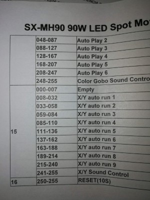

Dear friends,
I need your help for Led spot 90w fixture. I didn't find anything match till now.
Here is the DMX channels manual.
It should be the same as Varytec Hero Spot 90, but I did not find fixture on this product either.
It is very important and urgent for me.
Thank you.
