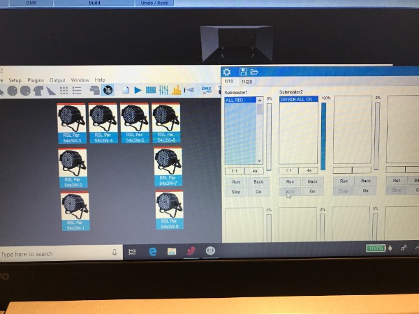

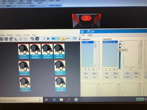

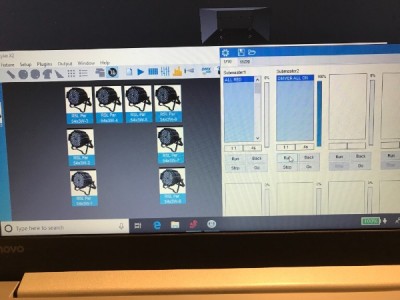

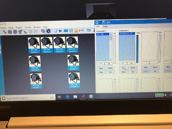

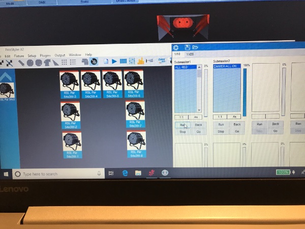

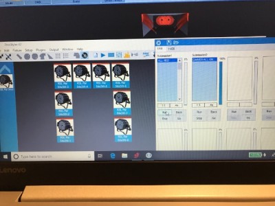

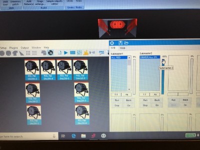

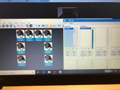

Hello, i have a query, i put 8 par lights red colour only channel on sub 1 and dimmer only for those 8 par on sub 2. So when i run them both no problems but each time i stop the dimmer the red colour disappear (normal) but when i run the dimmer again the red has stopped and i need to run it again, is there anyway this could stay on?

As no one has answered.
Is one of your sequences overriding a value?
For example, Here sometimes i accidently say "Move head in circle" but accidently tell it to blackout as well.
So when clicking "move head" it has blackout also assigned... (Open the sequence and check there are only the red icons next to stuff you dont want to change)

Re: Submaster question
Hello Lynxus,
Thank you for your help is much appreciated, I think you are right this is exactly what is happening I think, I will check it out again but I am sure it is what it is.
Thank you.
Pascal
