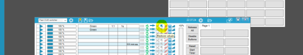

If the hazer was previously off and the cue is started you just need to enable restore values option in cue list but this would also reset any lights on the cue list,
it would be better to use the hazer on an override button, if you right click it you can ensure that 'flash button' is not selected so once you press it it will haze (at whatever you set in the sequence' and then when you press it again you will 'turn it off'
