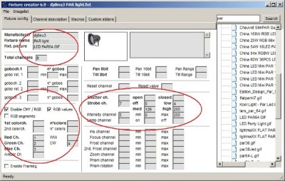

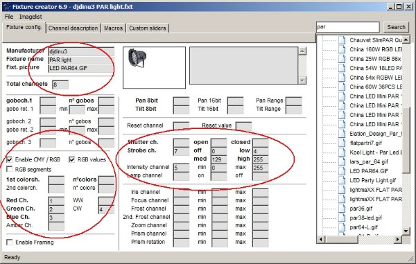

Hey djdinu3,
you did not specify the brand and model name of your PAR light, so I used the name "djdinu3 PAR light".
You may modify it to your liking and use another, more fitting picture or create one.
I attached a picture, showing the configuration in the FixtureCreator and the zipped fixture file itself.
RGBW color creation, dimming and strobing should work. You'll have to add "Color Changing" (suggestion: custom slider) and "Sound Mode" (suggestion: two macro buttons) yourself to the fixture file, or select via faders in FreeStyler (inflatable fader section in the upper right corner).
Here a short description of the process so you can create the file for the Big Dipper:
- Open FreeStyler FixtureCreator.
- Import an existing fixture file as a template or create a new one (custom).
- Enter brand and model name, choose a fixture picture (you can place your own in the Fixtures subdirectory in GIF format and about 60x60 pixel size).
- Enter total number of DMX channels (here, according to the PAR's manual: 8).
- Enter dimmer channel (and range) and strobe in the relevant fields (med strobe will be calculated automatically).
- For RGB(W) fixtures, mark "Enable CMY / RGB" and "RGB values" checkboxes and enter the channels. LED white is usually cold white (CW).
- Add more field and functions according to your fixtures manual, for example macros, sliders etc.
