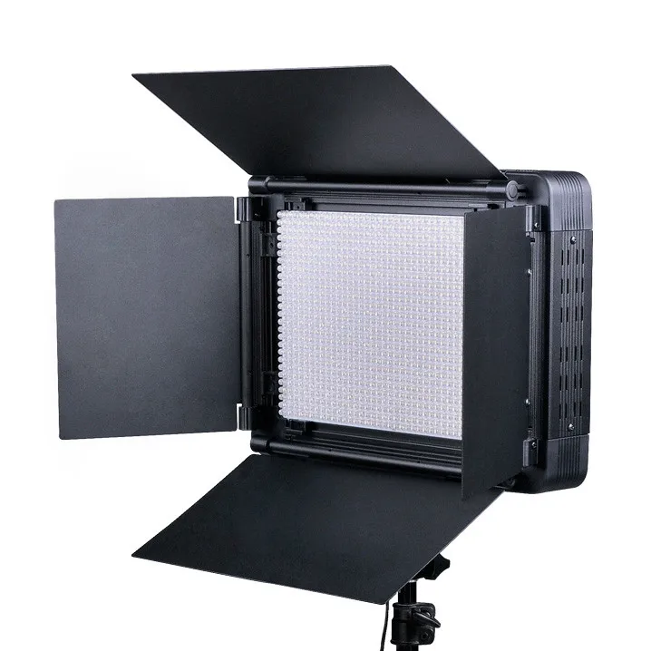

Hi I am a newbie, does anyone have experience with this type of fixtures NICEFOTO LED-1080DMX LED Flat Lamp DMX Control 204 LED Beads LED.
It's a very basic LED fixtures with 3200k to 6000k and 10step brightness. Which fixtures should I choose in freestyler?

Hi Rod, I have searched high and low but there is no manual for LED lamp.
I did some test with other fixture, the lamp works very basic channel 1 and channel 2.
channel 1 is White light intensity and channel 2 is the tungsten led intensity.
When both white and tungsten are on, it creates the different color temperature of 3200K~7500K.
Not too sure if anyone in the forum can help create a generic fixture for this, I assume most LED light panels are similar as they do not come with a manual as well.
