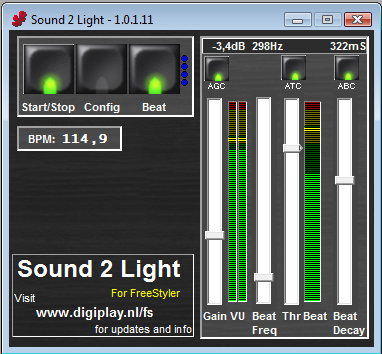

You all might know the current Sound 2 Light application that works with FreeStyler:
Version 1:
It is getting old. The world moves on. And so should old applications. Especially if they are used by so many users around the world, having newer operating systems with better functions.

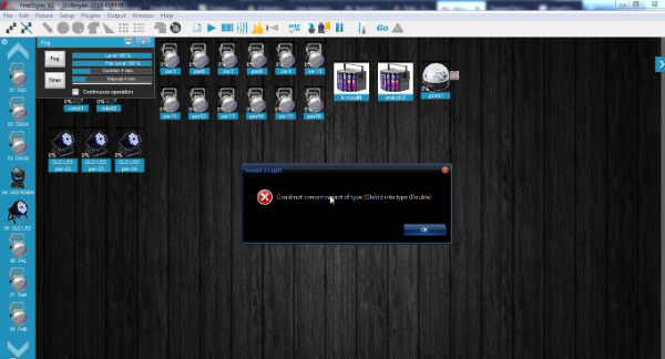

I downloaded it yesterday. Started it, and couldnt trigger anything, beacuse cannot received the sound (very noizy place, disco, wedding). But maybe some settings issue.
Today it doesn't starts saying:
"Cannot convert variable of type (OleStr) into (Double)".
Now i try to uninstall the v2, and get back the old version if i can.

Please create a bug report here: https://www.freestylersupport.com/bugs/
When submitting the report, attach the SL.xml for version 2 that is still on your system, I suspect it contains some invalid value somewhere.
You can find SL.xml for version 2 in the programdata path. It should still exist and be untouched, as version 1 doesn't know about this path.
Most of the time you can copy/type: %programdata%\Digiplay\SL in the address bar of your file explorer to get there, otherwise the path is similar to: C:\ProgramData\Digiplay\SL
If you're capable of finding a way how you can reproduce this problem, please describe the steps to do that.

Someone else reported a (very) similar problem by e-mail. There is a problem with the SL.xml configuration file.
I logged it into Mantis under Issue #1483.
https://www.freestylersupport.com/bugs/view.php?id=1483
If you have additional information about this problem, please add it there in the comments.
A solution will be available soon.

The problem described above is fixed in public beta v2.0.0.1
2018-06-11 - Sound 2 Light (2.0.0.1) Public beta release
  • Added some extra read/write configuration file error handling and information.
  • Fixed startup error "Could not convert variant of type (OleStr) into type (Double)" which was caused by certain locale settings in Windows. (Issue: 1483)
