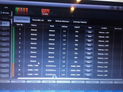

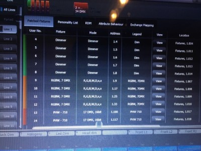

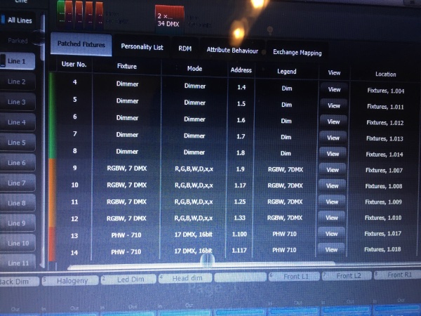

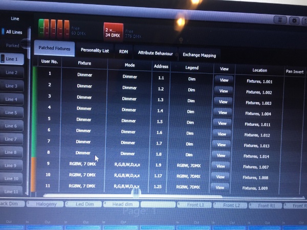

dennisgamalej
- Posts: 35
- Joined: 16 Oct 2016, 18:35
- FreeStyler Version: 2
Re: Help to select lights in freestyler
This are pictures from titan
- Posts: 879
- Joined: 16 Nov 2016, 14:24
- FreeStyler Version: 4.1.7
Based on your information and pictures (thank you) this is what I assume:
User No. 1 - 8 [Dimmer] [Dimmer] represent the 2 dimmer packs (each pack has 4 channels). The 6x cinelight junior fresnel 1000w and 6x par lamps without name are connected to the dimmer packs. You stated that you think they are connected to 1 channel on the dimmer pack. According to the user manual each dimmer pack has a 16 amp maximum capacity. Each channel has a 6.3 amp maximum capacity. At 230V or 240V the total amperage of the 12 instruments exceeds the capacity of the dimmers (I computed the amps for the unnamed pars at both 500W and 1000W) thus I assume you do not run all 12 instruments simultaneously.
User No. 9 - 12 [RGBW, 7 DMX] [R,G,B,W,D,x,x] represent the 4x beamz led pars 64 18x12w.
User 13 - 14 [PHW-710] [17 DMX, 16bit] represent the 2 futurelight PHW 710E
Attached is a fixture definition for the Beamz LED Par 64. It is a 7 channel fixture. The representation in your picture is somewhat confusing. The description [RGBW, 7 DMX] [R,G,B,W,D,x,x] seem to indicate a 7 channel fixture. HOWEVER, each fixture definition is defined for 8 channels. Also, the [R,G,B,W,D,x,x] may indicate a dimmer channel for the instrument. The user manual (also attached) does not show a dimmer channel.
In Freestyler, you may use any single channel fixture definition for your unnamed pars and your fresnels. Find a fixture where the picture is similar to your instruments. Do you color gel your instruments? In my setup I have fixtures for each of the colors with which I gel the instruments. This helps me when I develop a sequence or, more importantly, when I run live.
