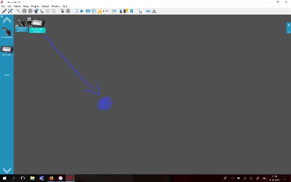

how to move fixture in main screen from one place to another
dennisgamalej
- Posts: 35
- Joined: 16 Oct 2016, 18:35
- FreeStyler Version: 2
how to move a fixture in the main screen from one place to another.
- Posts: 905
- Joined: 16 Nov 2016, 14:24
- FreeStyler Version: 4.1.7
Re: how to move fixture in main screen from one place to another
In the top menu click on Edit then click on Move Fixtures
Select the fixture or fixtures you want to move then click and hold on the/a fixture.
Drag the fixture(s) to the desired location and release the mouse button.
When you are finished moving the fixtures click on Edit then click on Move Fixtures to remove the check mark.
Note that if multiple fixtures are selected they all move as a group.
or just right click on a blank area of the freestyler screen and select "move fixtures"
