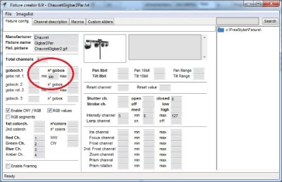

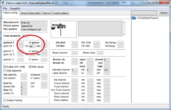

Hej Rod_Horning
I imported the par fixture and got gobo min error.
It is an error from Fixture creator 6.8 and should have been fixed in 6.9
http://www.freestylersupport.com/bugs/view.php?id=1347
Can you please tell what version of Fixture creator you are using.

Hi Jan
I am on version 6.9. I remember that error (I think I also reported it in Issue 0001348).
Regards,
Rod
Regards,
Rod
Jan_K
- Posts: 1155
- Joined: 04 Jan 2011, 21:57
- FreeStyler Version: Beta
Re: I need a fixture for Chauvet GigBar 2
The funny thing is if I save your "par" after clearing the error field then I can generate a new pff file without the error.
What happens if you try to import the "par" pff again.
Do you then also have this error.
And if you have the error can you then clear it and generate a new pff without the error
- Posts: 905
- Joined: 16 Nov 2016, 14:24
- FreeStyler Version: 4.1.7
Exactly the same as you found. Imported the .pff and saw the error (in my case the field turned red). cleared the error and saved and exported the fixture. Closed Fixture Creator. Opened Fixture Creator and imported the pff without the error. I started with the pff on my computer so the upload/download is not the issue.
that should be a fun bug to find.
Jan_K
- Posts: 1155
I have the original file with error in and I will add that to the bug tracker so it can be checked.
