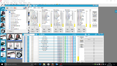

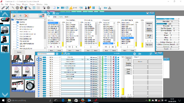

Having had a little time to spare, installed v34 on another laptop with a restored backup of cues from laptop running v32.
First issue when trying to change a sequence, ( see screenshot,2nd Sequence into F50 control) clicking on quicksave was not reflecting change in Submaster list, had to do a save as and overwrite before this would update. Tried this in v32 and quick save resulted in a immediate refresh in submaster list. Then tried setting all Submaster to Slider Controls Speeds, however on my touch interface Submaster 3 level was at 0% but speed at 100% toggled a few settings and it eventually came up to 100%. I have a set of sequences on Sub 1, that is overall for several lights, then 2 for generally dimmer on 8 Fusion 50 Moving colour wash, then sub 3 for colours on them then sub 4 for movement. In v32 these all work perfectly with LTP as expected, however in v34 some of the dimmer chases on sub 2 behave strangely, ie one which does a dimmer chase through 4x F50 (mirrored between two groups of 4), on first run cycles through both pairs of groups but on 2nd cycle one groups dimmers stay of all the time. If you run the cue in the sequence editor it behaves as expected and as I say works perfectly on subs in V32. Maybe I am missing something ?
Also I need the option to override levels via subfader to bring group level down, so am sticking with v32 for time being, was there a version 33, as I have had no issues in upgrading in past had jumped straight onto v34 without checking I had previous last version to go back to.
