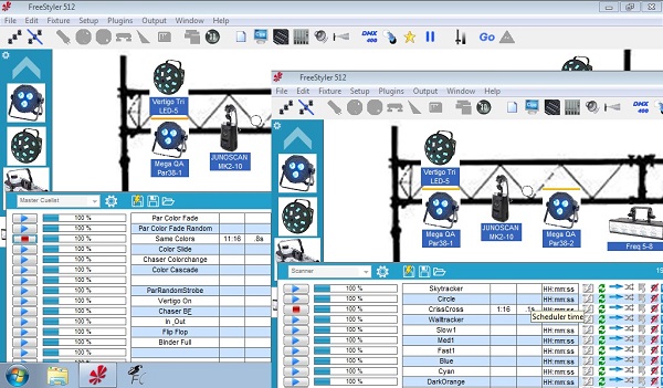

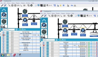

Blockparty
Posts: 9
Joined: 21 Apr 2015, 19:37
FreeStyler Version: 3.5.5
Re: Only Button Control?
Post by Blockparty »
I give you some visuals:
I made those cues real quick. the first one contains:
- controls over my pars (different programs and stuff)
- my vertigos
- some blinder/ chaser stuff
and well this gets the first cuelist pretty much to an end.
so now I made a second cuelist like you said for my Scanners:
- Complete Shows
- Movement Sequences
- Color Sequences
- Gobos etc
-> page 2 also full
But when I start the pars in the first cue and Switch to cue 2, then the pars still Keep doing what they did, but reset tempo/ flashing very fast. Now Seq 3 on page 2 is blocked - I cant Combine my pars with the scanner :S You know what I mean?
