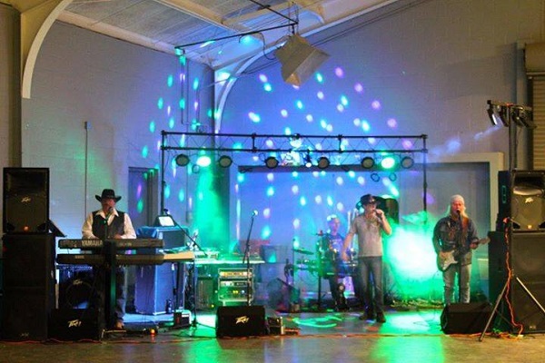

Re: Tablet / controller suggestions
A shot of the band with the new truss, snowball and 4-bar. The Swarm is out of view to the left. You can see the new laptop behind the keyboard player on top of the bass cabinet. This is really a testament to how awesome FS is and why ultimately I decided to stick with it instead of throwing way more money into a good programmable DMX controller and trying to learn a whole new system. I was able to reprogram every chase I had to include activity on all those new fixtures in about an hour and the system ran perfect all night.

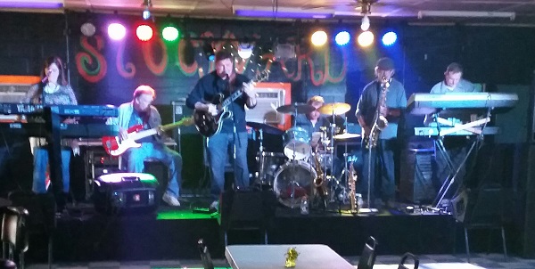

Thanks. It looked better last weekend when I got my Chauvet CLP-10's on the PARs so I could mount them 4x4 like I wanted as you can see in this pic.
We had a benefit going on and we provided PA and lights for the day. That's one of the other bands from the day. I got some very nice compliments on the rig. I also got to try out the Android App which was surprisingly easy to setup. I only had an issue with FS crashing a couple times and stop responding, I believe it happened whenever I closed the app on my phone and tried to reconnect later. I managed to add the Shinp DL-22GP to the fixtures and using one of the fixture files I found here I was able to turn it on/off. Made the show look a lot better and I added a new chase called "FREAKOUT" for the end of some songs where I kick in the strobe effects on the Snowball and 4Bar and flash my PARs back and forth really fast. I'm going to have to add DMX foggers soon
