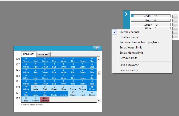

If you use the fixture I uploaded where max is 255 and then in Freestyler inverse the channel.
You select the fixture.
In right side of Freestyler the are a fader / slider panel.
Right-click on the dimmer fader and select "inverse channel"
And you should be up running.

Awesome! I learned a few more tricks today... Thank you for the tip about being able to right click the slider panel. Worked like a charm. I have about 150 sequences created so it took a bit to change the lamp to on for the ColorSplash. Most are only 1 or 2 steps but a few have as many as 30.
