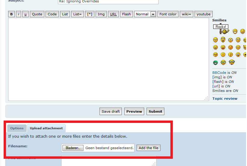

Sure, but I'm not quite sure where to send it. There doesn't appear to be an attach feature on the forum.
Spirit
Pro Supporter! (Moderator)
Posts: 1421
Joined: 10 Jul 2010, 20:55
FreeStyler Version: 3.5.9
Re: Ignoring Overrides
Post by Spirit »
yes there is.. ;)
