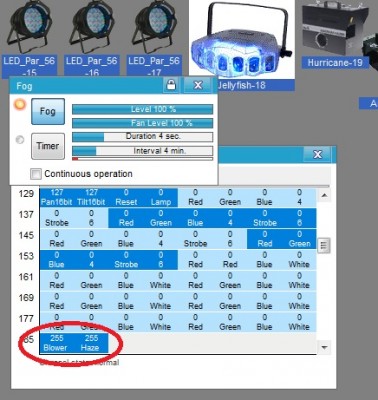

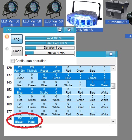

My Fog / Smoke Panel does not work. I can control the hazer using the right-side sliders without issue, but the panel does nothing.
Does the haze machine need to be set to a specific address for the panel to work?
The fixture has been set up as a fogger-hazer using the fixture creator - not as par, light, etc, but created as a true fogger-hazer.
Thanks for your help.
Gerry
Gerry

If you open the output monitor then you are able to see what FreeStyler sends on the dmx channels to the fog machine.
I just made a fast test and it seems to work.

Thanks, did that. The output monitor shows nothing is happening using the panel. The only time there is activity is when I use the right-side sliders.

When I press "Fog" then both channels goes to 255
I am not sure what is happening if it works with the slider in right side of FS and fail with the fog panel.

So I created a New Location on FS. Added a few existing hazers that came with FS (Radiance, Magnum, Minihazer) one at a time, deleting the previous and still no dice. I then tried creating a new one with the level on ch1 and fan on 2. Still no luck.
So I installed FS on my bootcamped MacBook pro and installed the drives for my USB-DMX512 dongle. Tried again and no luck still.
The only thing the two laptops have in common is my USB-DMX512 dongle. Think that's it?
