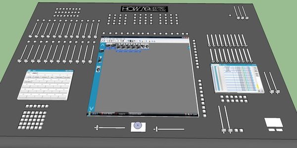

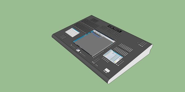

hello,
I am new here but not to freestyler.
I have a few questions that can be answered here.
1st have designed a midi console.
i have the finished cad drawings but would like feedback on ideas. if i can figure out i will add pics. it has 1 15" touchscreen and 2 7" touchscreen monitors as well as buttons and faders as follow. everything is arranges in similar layout of freestyler for ease of use. please let me know if I am forgetting any major items needed.
the buttons and sliders are as follows:
over ride buttons
tabs for over ride pages
cue buttons and page buttons for cues
scene creator buttons,
for buttons and faders
24 faders
24 buttons
extra buttons
speed faders
mouse
keyboard
joystick
to horizontal faders
group buttons
master speed
master int.
usb input
monitor output
also building in a version without pc build in it will have 3 monitor inputs and usb connection to hook to existing computer.
i cant put a button for every feature (there will be 3 touch screens and a mouse and keyboard on a drawer that slides out) but i want to cover all of the common used buttons.
i have to submit the cad file to the shop Thursday so i want to be sure i have all buttons and faders cut out. the graphics shop also needs their copy by Friday to overlay the metal.
thanks in advance.
matt
also how do i send a message to ralph? or does anyone know how i would go about changing the size of the cue window and the override button window?? also can the fixture group window be moved?

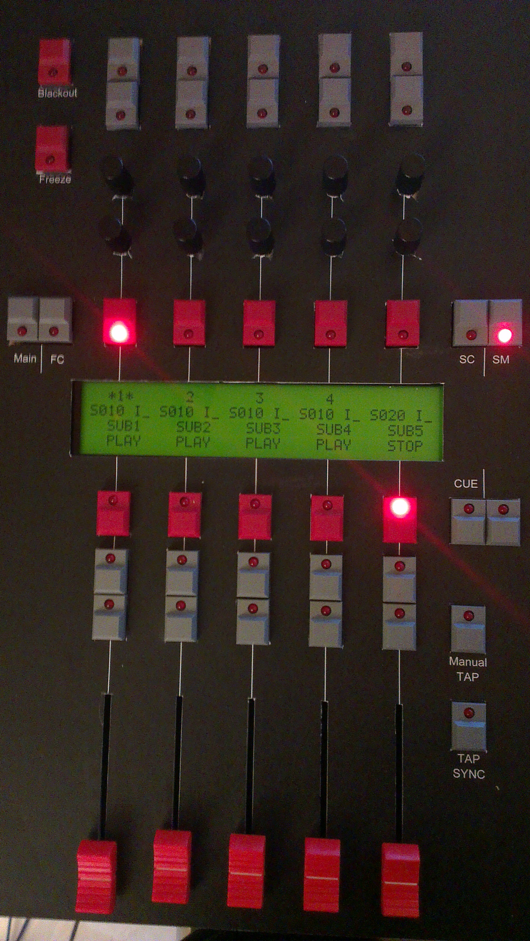

hi
i think i'm the master here about creating your own Conroller surface. and midi/touchscreens
i'm all ready busy for about 1 year on my build and i allready have the final product that works..(See image) therse also a Video on the Freestyler facebook.
but i allready Thinking about it for 2 or more years..because i cost allot of money and i did not like to have a Controller i did not like realy quick..
and here a other image with a Touchscreen build in a Flightcase
https://www.dropbox.com/s/maieubl8eqllmew/IMAG0152.jpg
and at the moment i allways bring my BCF2000 with me..
i also build a idea with 3x 15"touchscreens + 3x Bcf2000 but in the end it was Way! to Big and i did not like the layout from the BCF2000 there also should be a image somewhere on the Forum..

on the midi device with real buttons i also add some overridebutton i Use ALLOT!!!
/spirit
