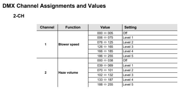

Re: Chauvet Hurricane Haze 2D
I have the hurricane hazer 2D and with any fixture profiles i can find, the fan only turns on when haze erupts. I want the fan to run constantly. How can i turn it on permanently?
- Posts: 905
- Joined: 16 Nov 2016, 14:24
- FreeStyler Version: 4.1.7
Attached is the DMX chart from the user manual.
Reading the user manual I do not see a way to configure the hazer so that the fan runs continuously. This is not a DMX limitation, it is the way the hazer is engineered.
If setting channel 1 to no haze (0,1,2,3,4,5) and setting channel 2 to some fan speed (39 - 255) does not give you the operation you want then it probably is not possible.
