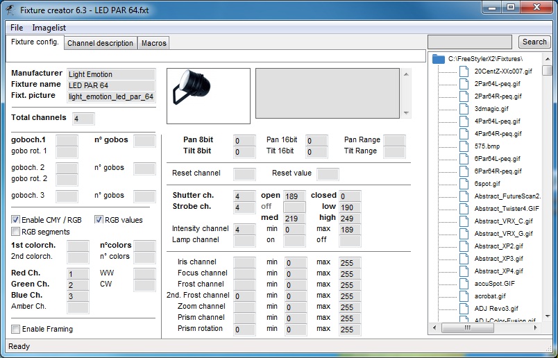

Hi. This is my first post here. I've been using FreeStyler since yesterday and needed to create a fixture file for our lights, which are (Chinese) Light Emotion LED PAR 64.
They're 4-channel with RGB on 1-3 then the 4th channel is dimmer from 0-189, strobe from 190-250 and the last 251-255 is full brightness (same as 189, it seems).
It is working for me. I hope it helps someone else. Comments appreciated.
(Updated file so Open/Close for shutter work and "Off" for strobe sets the lights to off.)

I'm not sure if I should ask this here or in a different forum... if it doesn't get answered I'll ask elsewhere.
I did not put a value in for the shutter channel, so I can't use the Open and Closed buttons.
If I do put channel 4 in, then the strobe doesn't work the way I want it: I want "Off" for the strobe to change to full brightness (dimmer 189), but when there's a channel set for shutter the entry box for strobe "off" is not editable
Channel 4 is intensity, strobe (and shutter)... what is the best way to get all features (strobe, dimmer and shutter open/closed)?
Thanks.
Thanks.

Re: Light Emotion LED PAR 64
Think I got figured out what you want to do.
The rest is the way you operate it.
When you press "Off" the strobe and the light goes off.
If you instead press "Open" then the strobe goes to full light.
and if you press "Close" then strobe goes to no ligth.
Thanks heaps for the reply.
I can't test it out now, but will do as soon as I can.
I believe I tried this before, but wanted to have "Off" for strobe leave the light at full. It seems the only way I can get that is by not having access to the open/closed shutter.
I think this way is better, so I get open/closed, but the strobe off turns the intensity to zero (instead of 189). This is probably more usable.
If my lights are strobing and I want to turn them to full light (previously this was "Off" for strobe), I should be able to just press "Open" and I get the same result.
How do I get the strobe (low-high) on a fader now?
Thanks!
First of all low, med and high buttons are still there.
And.
The way the lamp panel are build, you have one way to stop strobe.
"Open" or "Closed" you need to decide what state you want to end in.
The "Off" button was introduced because some fixture had a dedicated to strobe channel. (not mixed with the shutter)
In the case with your fixture I actually think it is an error that the off button is present in the lamp panel when no value is entered.
The right way to stop strobe is by using Open or Close.
And.
Yes, this works nicely now. Thanks.
It means that "Off" for strobe turns the light off instead of full (189), which I wanted, but it is much better to have the Open and Closed options, so I'm happy.
I've updated the file here now.
