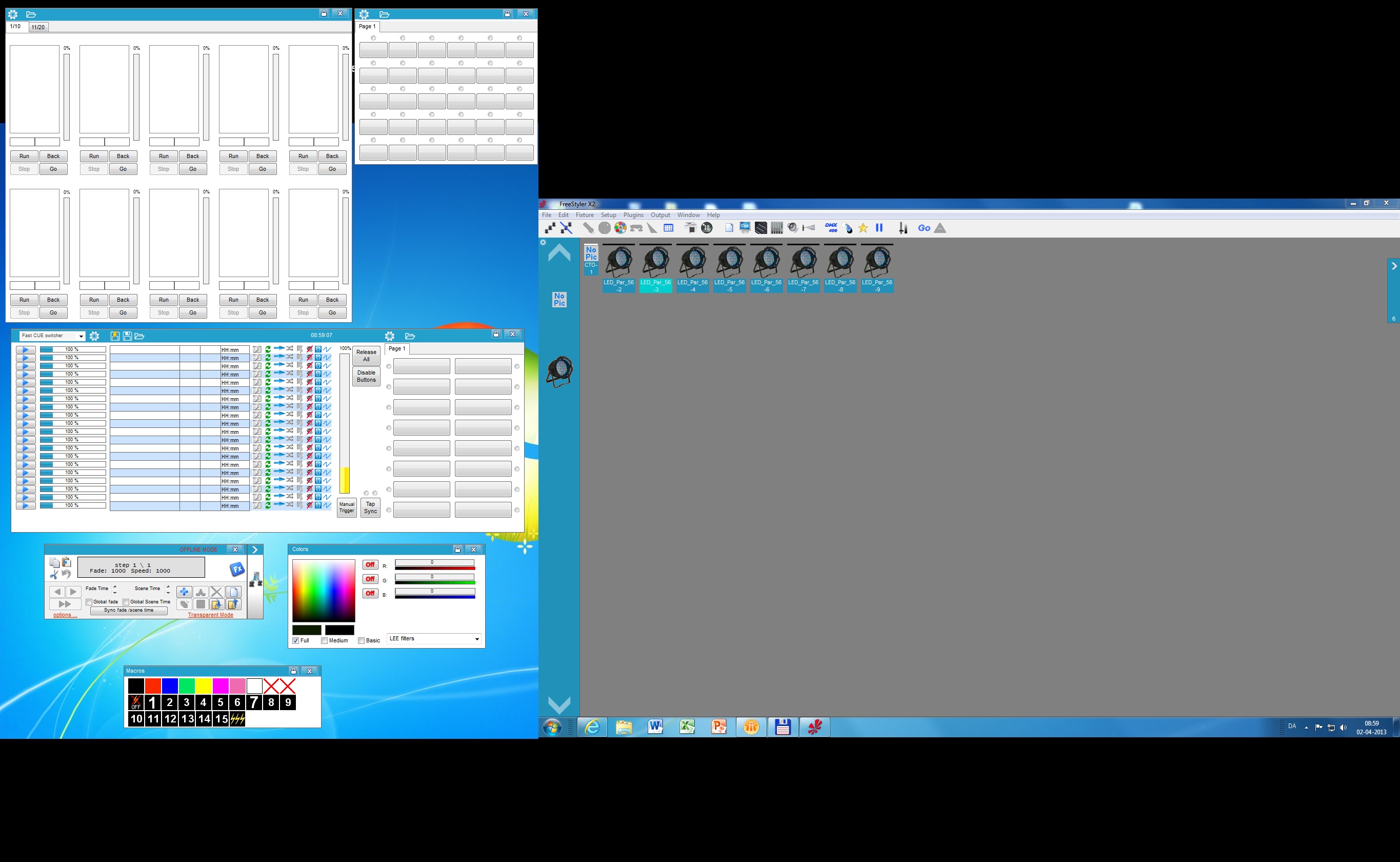

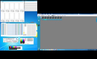

The Fixture control panels and the cue panel and so on are not locked to the Freestyler window.
I have two monitors where one is turned as portrait.
Have a look on screen dump image.

Thanks Jan, I had thought the Cue panel, sub master etc. were within the main freestyler window and not able to me moved outside. I will investigate this a little more although the Zones is providing me with a lot more room.
Thank you for the information
