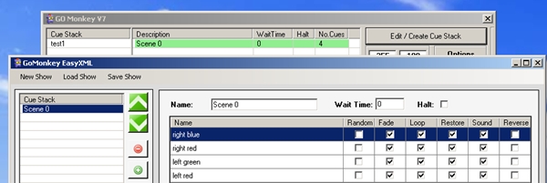

- Posts: 41
- Joined: 06 Feb 2013, 20:33
- FreeStyler Version: 2.96j
Re: stage lighting control
screenshot
I see your problem. You have made a scene made up of all your sequences. Seperate your sequences inyo miltiple scene's. Your list of scenes will appear in the left column of the editor
Also ensure you have set to allow playback of multiple cues in freestylers options.
Mal
- Posts: 41
Ah, so each scene contains 1 light change for each fixture, then add a new scene for each new light change? Generally there could be 1 sequence per fixture per scene?
Did i see somewhere that each XML can contain up to 20 scenes?
Each scene can have 20 sequences.
you cane have as many scenes as you like. (in the software a scene is displayed in the cue stack) the sequences are the sequences that make up the scene. the sequences are loaded into the slots in the cuelist in freestyler.
using your example
#scene one right red & left green
#scene two right blue & left red
so on your first click of the go button, the stage will be lit RED to the right and Green to the left.
you press go again and scene two will load the stage is now blue to the right and red to the left.
to start the next scene automatically ensure halt is not selected and set the wait time to the time you want the software to wait before moving onto the next scene.
using your example
