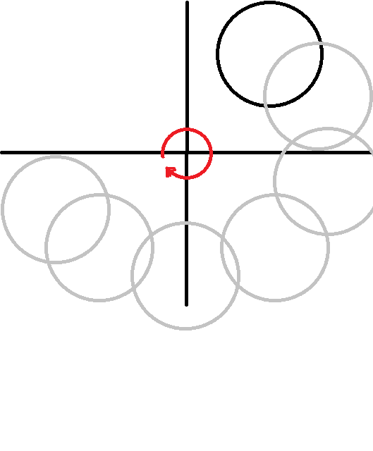

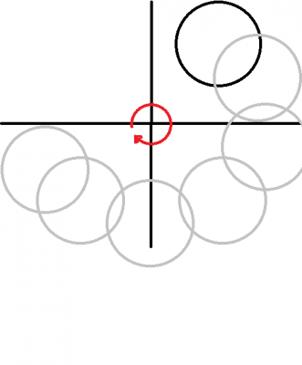

l have 1 problem with the rotation solution, I attached a image to describe a little better, but if you have a moving head that has a center point being the "up or down tilt and center pan" and you create a circle you would need to create that circle in one of the 4 quadrants. Once you change the rotation the circle moves around the center point of the XY crosshair not the center of the shape. Even so a phase or delay would not change the shapes rotation at all it would change the timing. For instance if you had a square and spun it on axis it would become a diamond eventually and not the square you intended for, but if you put a delay or phase on it, it would remain the same shape and look as if one light is following the other.
