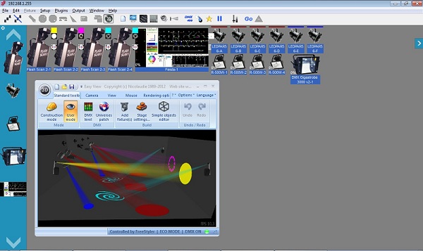

Hi @ all,
due to issues with the combination above (lightbeams not visible when not using strobe) I pointed this to the Sunlite forum and got the following answer:

Will there be an update in the nearer future? I would be really happy to get this working again soon ...

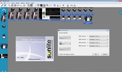

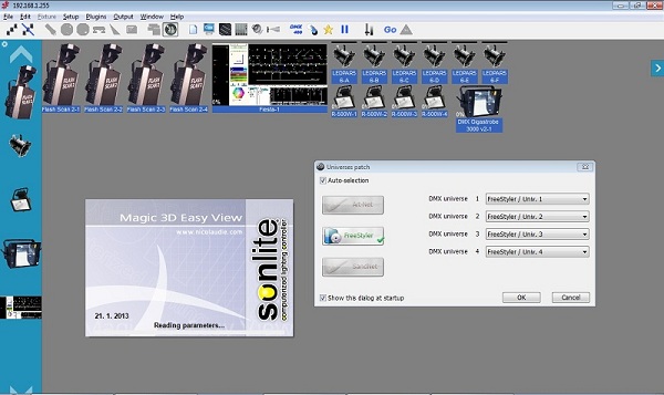

if I download the latest beta version and replace the easyview.exe, the DMX signal in Easy View 3D shows OFF and I've found no way to get it online. If replace it again with the original downloaded .exe which came with the automatic installation procedure, DMX control is online again but the beam issue is still there ...
