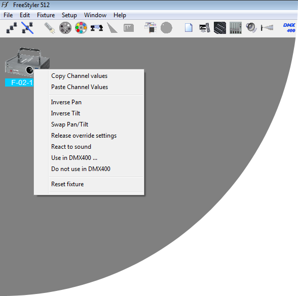

are u clicking on the fixture on the main screen or on the add/remove fixtures window? because it has to be on the main screen.... the icons etc.....

I do not have those DMX400 options. My right-click options are less.Image
I don't get it.
