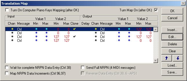

i was able to fix the problem with midi ox mapping.
now the toggle buttons are sending 127/0 with each button press and the led's are working.
this is the midi ox mapping that i am using
http://freestylersupport.com/fsforum/do ... &mode=view
