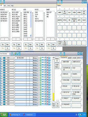

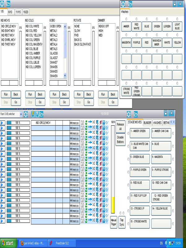

I have attached a screenshot of what I was using on the night however this was split on two screens so I have just put it on the one.

Re: First Freestyler Show Last Night, impressions and proble
Yes pfff lie finaly
But i see the problem or i see many of them
But creating the sequences can be Tricky.
First of all i see that the Cuelist buttons and Submaster Cant be used at the same time.
But as i see on your show i would recommend to Use the Submasters to Controll everything..
TIP: i know you can only have 4tabs with 5submasters each BUT if you use touchscreen interface 2 you can have all 20Submaster on One screen (You only need a Big screen for this)
Tips and Tricks For Submasters:
a Thumbe Rule, Each Submaster should Contain ONE fixture atribute/Channel.
For MH
Pan /tilt Sequences should contain Pan or/and Tilt 8bit AND 16bit. (only your fixtures have 8bit so Thats fine)
Color Seq. Only Color channels
Gobo Seq. only Gobo Channels
Prism Seq. only Prism channel
Dimmer seq. only Dim channel
Shutter seq. only shutter channel (Dim and shutter can be Mixed But be SURE!!! on all the sequences you add to the Dim/Shutter submaster needs to Channel set to FADE or SNAP on the Seq.)
For LED
COLOR seq need to have the R, G, B channels ( also be sure all sequence on that sub.M need to have the RGb channel set to FADE or SNAP to avoid strange behevair.)
Shutter Seq. only shutter channel..
i see you made all the sequences for the ledpars on the Cuelist buttons and i also noticed you úse the Ledpars mixed with eachother.
i would make this more clearer and Use one Sub.M for ROH 1~7 One for L1~3 and R1~3 one for Floor and one for Drum..
and the submaster looks Oke only the STROBE WHITE looks strange for the Movers but i'm not sure if this is the idea.
But i will make a Version of a Submaster show how i create it so you can Compare it with yours..
/spirit
For MH
For LED
/spirit

- Uriahdemon
- FS is my life
- Posts: 266
- Joined: 18 Aug 2012, 10:15
- FreeStyler Version: 3.5.5
- I Use FreeStyler for: Band
Hi Spirit,
If you mean the physical locations then basically its a truss bar at the rear.
Drum riser with drum pars on and sunstrip beneath. Then I have left and right columns with a moving head on the top of each and three floor PARS.
I have uploaded my stage plan and also a camera shot from EV3D to the dropbox link.
https://www.dropbox.com/home/Mac%20Open%20Access
Thanks for all your help on this and I look forward to seeing what you come up with.
Rgds Mac
Rgds Mac
