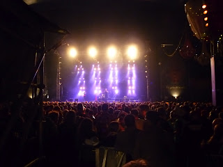

Hi Spirit, you are without doubt a guru. I have managed to get it down to a level that I can use EV efficiently..... it was the resolution as shadows were turned off.......thanks very much !!!
The examples of your shows you shared are very impressive. Is that your own rig....??
I am visiting Den Helder next month for work reasons but if you fancy a beer I owe you one or two !!!!!!

Unfortunately this isnt my Lighting Rig
But its a Stage from a Festival i have been.
i realy liked they way how they set it up.
so i just recreated it and it good for me so i also can Programm BIG show.
Just te learn how to do it. some new sequences i normaly never use.
this is the Best Foto i can find http://3.bp.blogspot.com/-Y1tzQ8I0fXA/U ... 040296.JPG
as i also see i forgot the Blinder on top of the stage.
/Spirit
/Spirit
