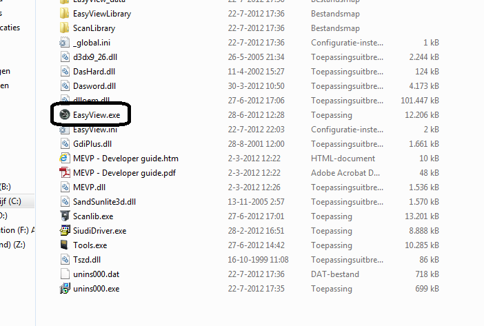

- Spirit
- Posts: 1421
- Joined: 10 Jul 2010, 20:55
- FreeStyler Version: 3.5.9
Re: I cant see the light beam!
oke
if you install freestyler it also ask if you like to install 3Dview.
this is realy importent because the 3d view you install with freestyler will only work with freestyler.
if you install 3dview seperate from freestyler, then 3d View will not work!
so Install the lastest beta from the Nicolaudia webpage as you allready did.
Now Copy the New (Beta) Easyview.exe file To the Freestyler directory so you replace the old easyview.exe with the latest easyview.exe file.
now start FS and open easyview. and it should work ok.
so in steps.
1) Install Freestyler with Easyview.
2) install the Latest easyview beta from the nicoladia page.
3) By default go to C:/SLMEV Beta and copy the Easyview.exe file
4) by default go to C:/Freestyler and Past the file there.
5) start freestyler and open Easyview and it should be working.
/spirit

- Spirit
- Posts: 1421
here
- Uriahdemon
- FS is my life
- Posts: 266
- Joined: 18 Aug 2012, 10:15
- FreeStyler Version: 3.5.5
- I Use FreeStyler for: Band
OK thanks. I didnt see any .exe at the end of mine. I will give it a try now.
