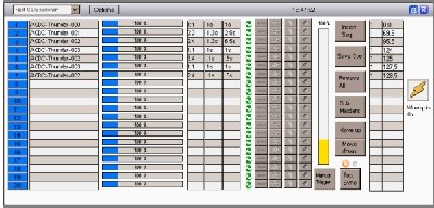

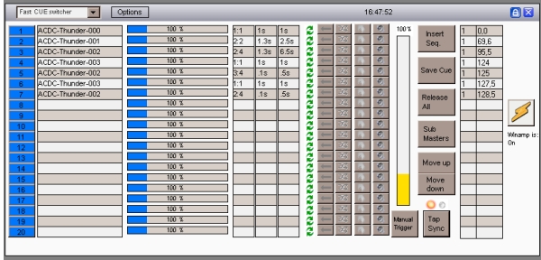

I have read the posts on this board about winamp and so I find out how to use the timecode.
But 2 Questions:
- Is it possible to exactly 0,1;0,2;0,3, ... trigger by music? If I make 0,3 > 0,2 I think that is come 1 Second before.
- Why sometimes my Sequenzes, which should start with the trigger run "Loop" and the blue button keeps red (like I want it) and why sometimes the Sequence were only swithed "On > Off" and the buttons go "Blue > Red > Blue" in a second?
