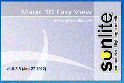

Re: Magic 3D Problem
Looks like mine is a bit older.

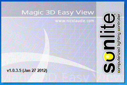

yes i also run version 2012.5.21.3054
and just like to add to it it's finaly a version that seems to work %^$#& great again.
allthough i did need to recreate my fixture's again, to let it work Perfect.
but i am realy happy with the lastest version.
