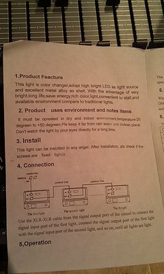

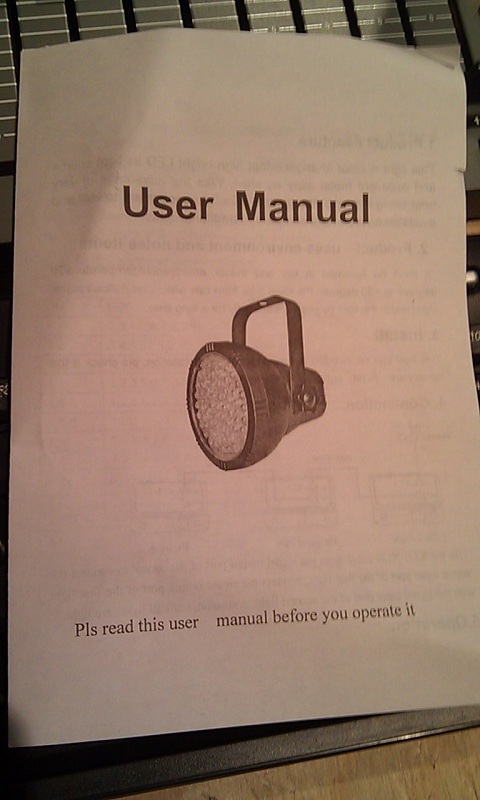

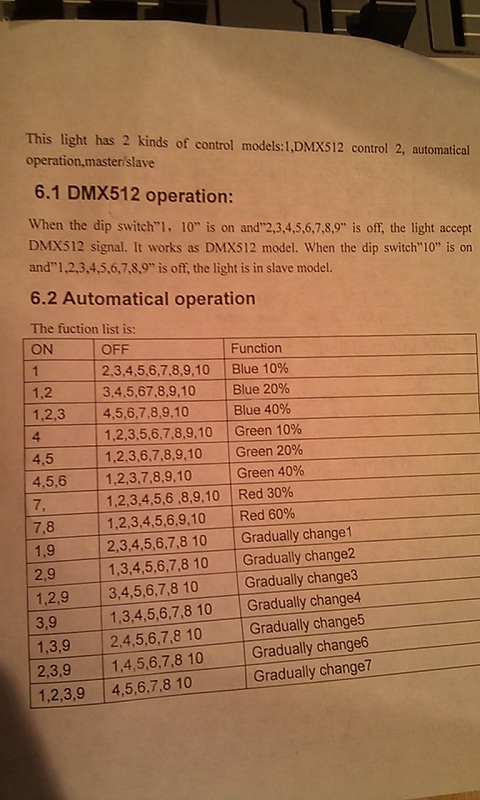

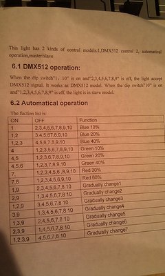

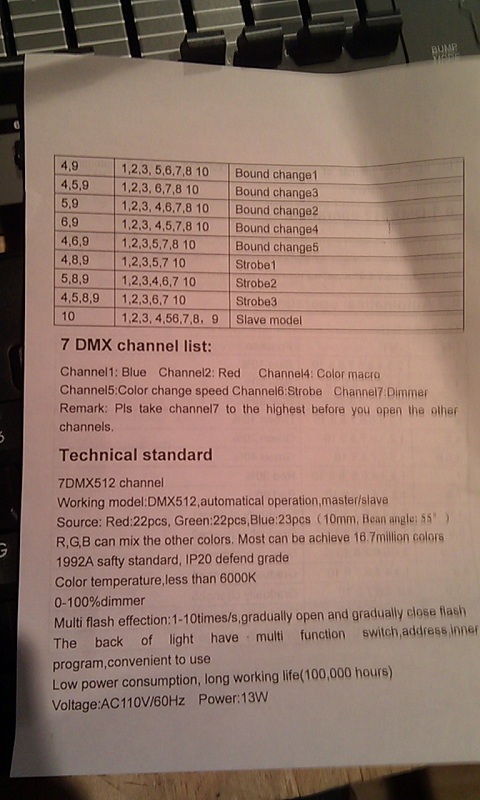

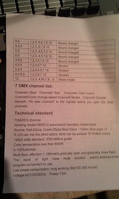

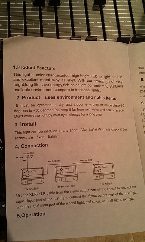

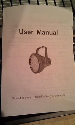

tkodarkside321
Re: Completely New To This!!
Here are the remaining 2 pages of the manual for the led par cans.
tkodarkside321
Sorry, the pictures of the manual uploaded in the wrong order, but I'm sure you can figure it out
Thank you so much for your input!!! I'm hoping once I can get the basics down, I will start to figure out the more advanced aspects of this software.
- Spirit
- Posts: 1421
- Joined: 10 Jul 2010, 20:55
- FreeStyler Version: 3.5.9
Hi.
Oke it should be the 7ch Channel fixture.
I can give you 3 Tips.
1)Be sure that all the fixtures are Patch correct.
2) If you use Colormarco then the RGB channels will not React.
3)Pull the DImmer to 255 Otherwise the RGB will not work.
/spirit
/spirit
Jan_K
- Posts: 1155
- Joined: 04 Jan 2011, 21:57
- FreeStyler Version: Beta
Hej Spirit
Found this one on stageape.com led stud. http://www.stageape.com/pages/stud.html
It looks like dip switch 10 has to be on in addition to the address
@tkodarkside321
FreeStyler will give you all the adresses when you add them but that you have prob. seen.
Fixture addresses in Freestyler and on the Led fixtures has to correspond.
@tkodarkside321

Jan_K
- Posts: 1155
Hej tkodarkside321
!!!!!!!!!! Ups! Was writing a post in Word before sending it so You came in between Spirit
This sounds like your Lamps (Fixtures) has a wrong address setting.
You have to look on the rear of them and check them. (don’t hope they are mounted under the ceiling.)
You have to set fixture 1 to address1 and fixture 2 to address 8 and so on.
Additional it looks like switch 10 are to be set on.
1:1
2: 8
3: 15
4: 22
5: 29
6: 36
7: 43
8: 50
9: 57
10: 64
11: 71
12: 78
If you are not familiar with the binary numbers then read the link Spirit send to you specially how to set the addresses.
Take eventually a snapshot of the address on one of the fixtures so we can guide you.
1:1
2: 8
3: 15
4: 22
5: 29
6: 36
7: 43
8: 50
9: 57
10: 64
11: 71
12: 78
