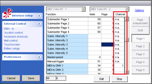

In the External Control>>Midi Section are some points called "Midi to DMX ...." For what? When i assign a note to it nothing changes in the desired DMX output channel. So for what is it and how can i use it? There is also nothing in the WIKI.
It would be nice if i could assing a Midi-Note to an DMX-Channel (1-512)......Maybe a feature request?

Thats what Midi to DMx does.
But you also need to assign a DMX channel to it.
if you go to the Midi options and you go to the Midi to dmx.
you will see
Note - page - Channel
and Under the Channel you see "n.a." but with the midi to dmx you see this field is empty and there you NEED to fill in the DMX channel.
you will see
