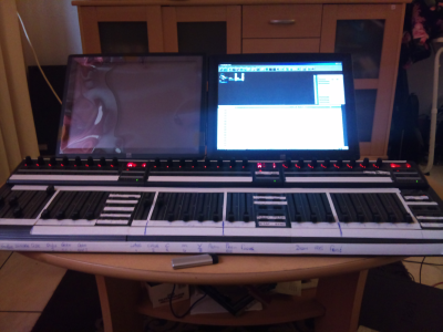

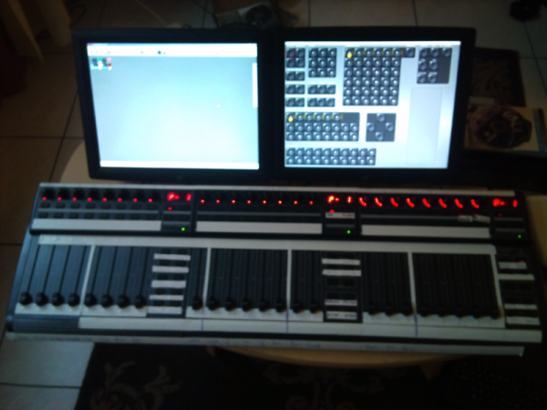

Hello, everybody
just like you show my lightingdesk so far it's still a work in progress.
(144.08 KiB) Downloaded 1 time
At the moment having some troubles with the Second screen i use a Usb->DVI converter but it shows some trouble. so need to figure that out.
The bcf's works realy great, i have them all on a USB hub and it works, and i use Midi ox to merge the channels to one channel so freestyler can work with 3x bcf.
still need look if both the touchscreen will run with Windows XP.
but i allready found a tutoruil about thats, so that should be easy.
and if all the software and hardware like to work with eachother, i will let somebody else make a custom Fightcase so everything will fit.

Oke so far everthing seems to work great. :D
i Just used a Old Pc of mine (AMD 2x3GHZ 3GB Ram + Videocart for the 2 screens).
Still i like to have a Nice working USB->dvi converter so i can add a Thirdscreen for 3d View iff needed.
But the 3x bcf and 2x touchscreen seems to work nice.
Now i need to think about the Flight case.
