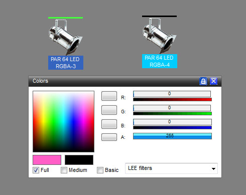

Hello, good morning Spirit,
the thing is I do not have the problem only in 3dview, but also in freestyler.
I've join a screenshot which shows you that the select par 64 has the amber at 100% but the color is still balck in the color panel. and the little strip on the top of the icon of the par is also black.
the second par on the left side of the picture has green color on the icon strip, color selected in the color panel.
If you could have a look into it?
many thanks again.
best regards.
Patrick.
Spirit
Pro Supporter! (Moderator)
Posts: 1421
Joined: 10 Jul 2010, 20:55
FreeStyler Version: 3.5.9
Re: EUROLITE LED PAR 64 RGBA fixture
Post by Spirit »
Like i sad the amber channel is new.
Because if you open the show output window you can see it works great what you mean is more cosmetic.
Please conect a real light to freestyler so you can see in real what is does.
/spirit
